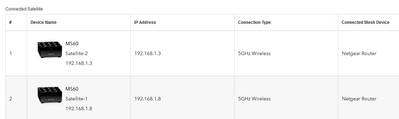

Hi,
I have a Netgear Router MR60 with 2 satellites.
I noticed that the 2 satellites are broadcasting the 5GHz but not the 2GHz. This is causing issues with the smart door lock and the Garage smart controller not getting the signal strength even if the satellite was placed in the living room.
I couldn't find any option to turn on in the Admin console.
Any ideas, suggestions?
Thanks

What tells you that the satellites are not broadcasting 2.4 GHz?
The screenshot you post just tells you that the satellites are talking to each other, and the router, at 5 Ghz.
By design, your MK63 system is "smart" and uses the same SSID for 2.4 GHz and 5 GHz. It is then down to the wifi clients to connect to the most suitable band. If you have 2.4 GHz devices they can't see 5 GHz.
Look at the rest of the Connected Devices list to see the devices connecting to the MK63.

I got the Android App called NetSpot and figured out it was transmitting on both the channels, compared to the other apps I was using to figure out. It also gave me the signal strength and zones that helped to figure out the positioning of satellites.
