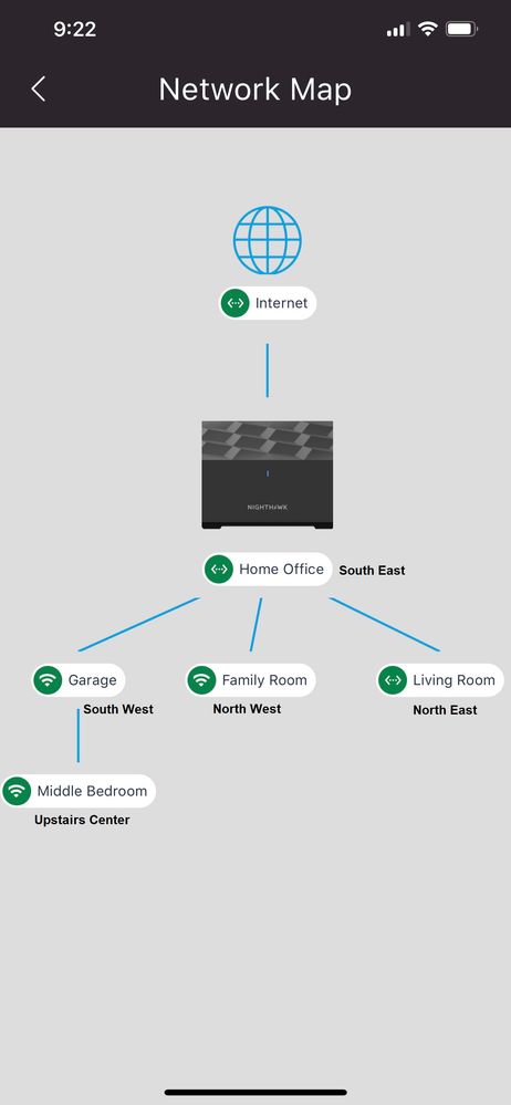

I have a WiFi Mesh setup at home with 1 MR60 and 4 MS60s connected to it as shown in the attached picture. I have Wired Connections from Home Office where MR60 is located on South East corner to Family Room and Living Room on other corners of my home.
Ideally, I would like MS60s in Living Room and Family room to be connected through the wire for backhaul. Unfortunately, as soon as I connect both MS60s on wired backhaul, the WiFi system becomes unstable; randomly various MS60 satellites will show disconnected. I tried multiple trial and errors with network ports at Family & Living rooms or directly inserting the MS60s at ports in Home Office. The conclusion is that 2 MS60s on wired backhaul causes problems. So, I am operating right now with only Living Room unit on Wired backhaul and rest are wireless.
Is anyone else having similar problems?
Any suggestions on how to troubleshoot and fix the issue?
The issue is reproducible.

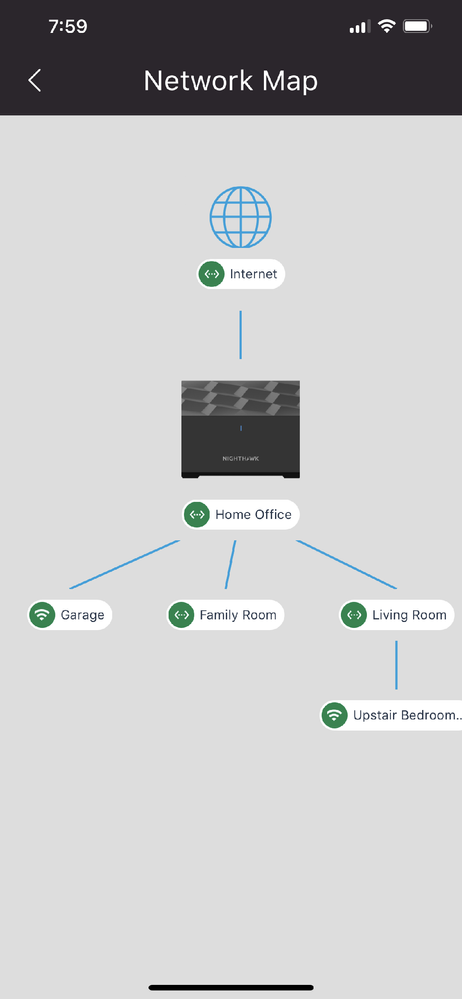

  • FURRYe38 Thank you so much. You nailed it.
    The culprit was Netgear ProSafe GS110TP. I swapped it out with Netgear ProSafe GS108 and reconnected MS60s in Family Room and Living Room through wire. They started working and the other 2 MS60s are connected Wirelessly as there is no drop there. I have the home network the way I want configured.

  • Here is the Network Map after the issue is resolved by replacing the intermediate switch. As you can see 2 MS60s are connected through wire and other 2 are connected Wirelessly. This is exactly how I wanted my home network to function. Thanks FURRYe38.
