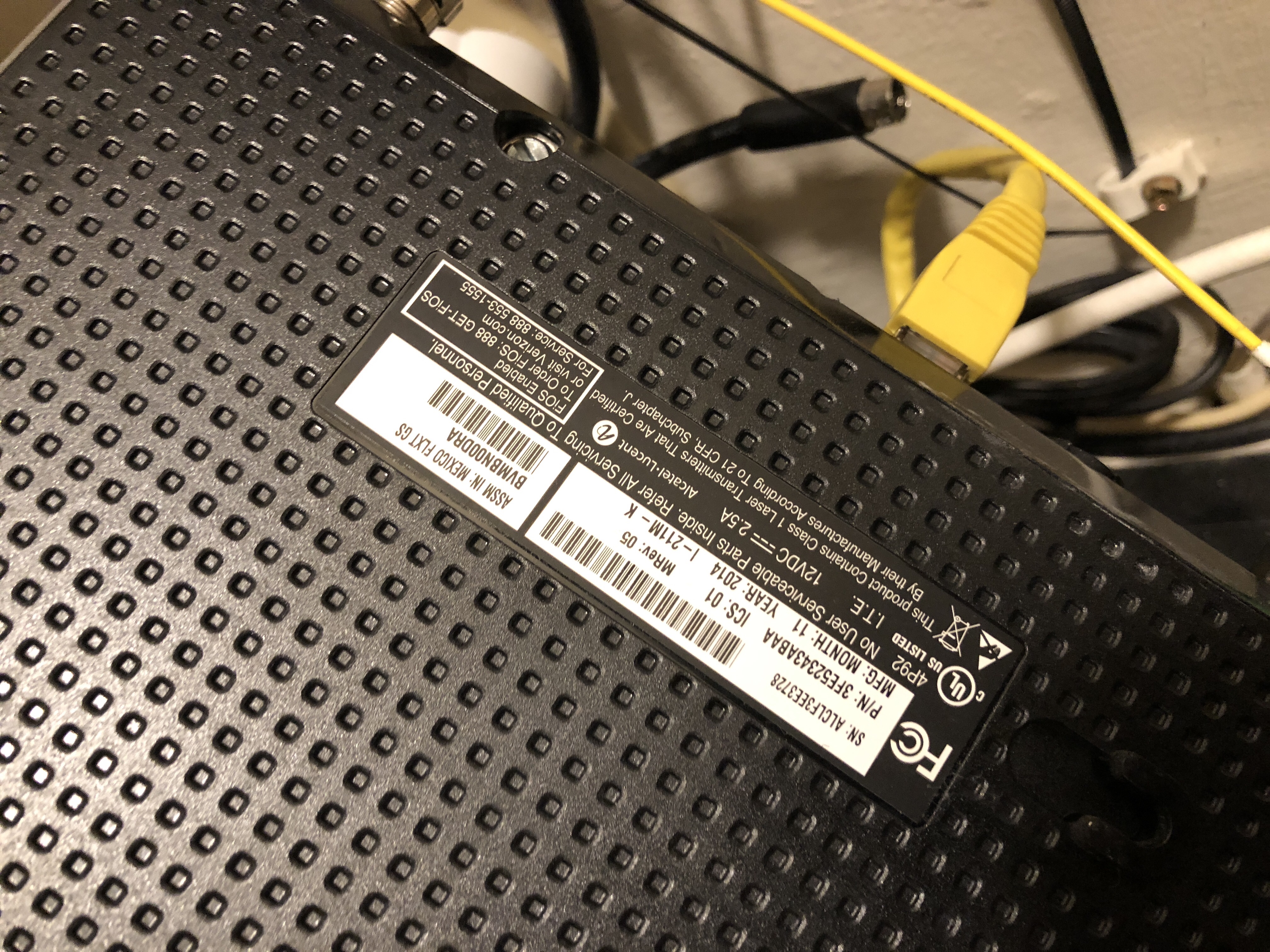

      Still no luck with anything. I didn’t have much time to mess around with it since I’ve had to work late. I attached the picture of the model number and all. Going to try calling Verizon again to see if there is any issue on their end
      • FURRYe38's avatar
        Ok, keep us posted. Ya, no model # information on that FIOS sticker. There nothing on the front top or bottom markings for model#?
