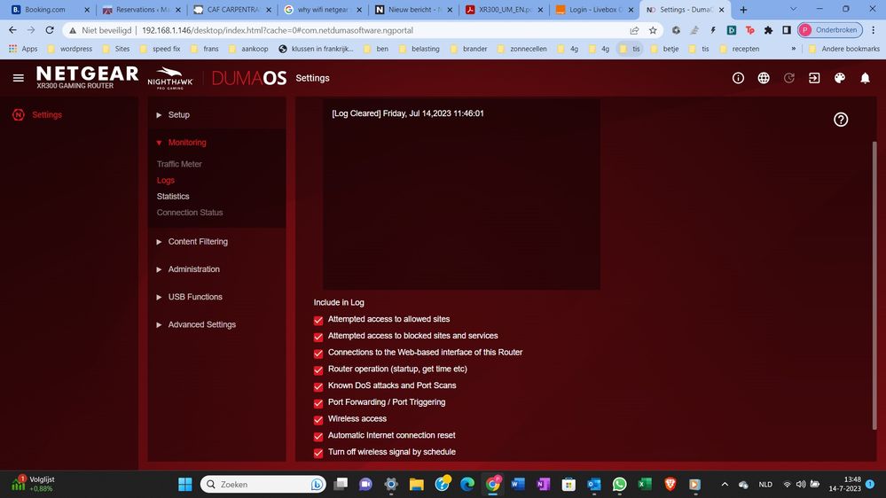

Is should register the logging of the wifi, that does also not work.
