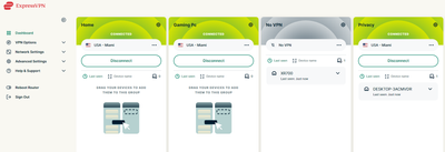

      Thank's for the in took 2 weeks of trying to figure out when my called express support.  Which they said  comast-netgear-aircove that didn't work at all I finally figured out that I need to separate the 2 computers all together. comcast - aircove - work pc, aircov second port ethernet  connected to my netgear but setup as novpn grouping so it dosen't block port forwarding for my games . So far working great. Thanks again.
