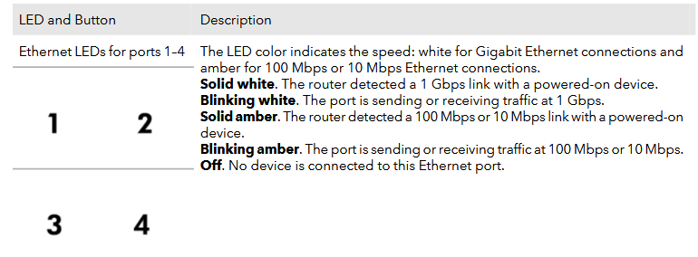

    Interesting that the LED on LAN ports blinking red every 5 seconds is not a condition shown in the R300 user manual:

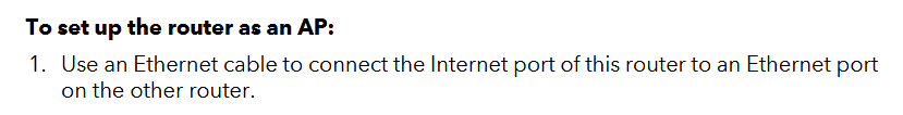

      It has to be a LAN port on the XR to the internet port on the AX then it will work

      If the AX4 is in AP mode, then normally you'd connect the cable between an XR300 LAN and the AX4 WAN port.
      • arewe3's avatar
        arewe3
        Yes, it is connected from XR300 LAN port 4 to AX4 (in AP Mode) LAN port 4.  I have tried different ports.  I have not connected it the WAN ports because I am positive that will not work.

      I connected the main XR300 router from local ethernet port #1 to the RAX35 router (in AP mode) to the yellow port (WAN).  Still do not get a connection.  the XR300 lights that show which LAN ports are active is still blinking amber every 5 seconds.

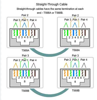

    There are two "standards" for RJ45 connectors: T568A and T568B.  Can you verify that the cable pairs are wired the same way on both ends?  (A vs B)

      Both sides of the cable are T568A standard.  I know things like fluke meters can detect breaks in cables and give a general distance.  I might look at going with a wireless solution because the cable will be very hard to replace.
