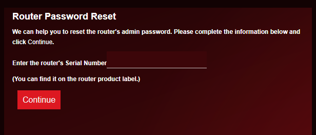

  1. Went to the Admin home ( 192.168.1.1 )
  2. Got shown this screen
    What the heck!?
  3. Entered S/N

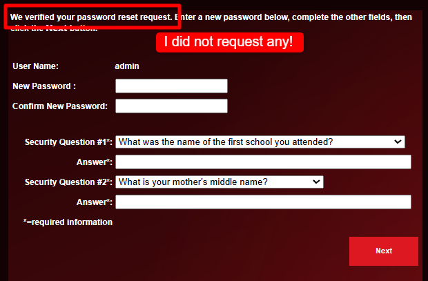

  4. Got asked 2x Security Questions, answered correctly
  5. Got shown this screen now
  6. Entered & confirmed new password
  7. Answered the 2x Security Questions (again!)

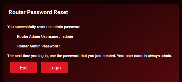

  8. Got shown the success screen
  9. Both "Exit" and "Login" button directed me to Step 2 again 😣

    One silly thought:  When filling in the new password page, did you actually click on the Drop Down Menu and select which security questions to use (or did you merely fill in answers to the two questions which were already showing)???
    • kevinMario's avatar
      kevinMario
      Good question CrimpOn​
      1. did you actually click on the Drop Down Menu and select which security questions to use, or
      2. did you merely fill in answers to the two questions which were already showing
      If memory serves me right, I'm pretty sure I did #2
