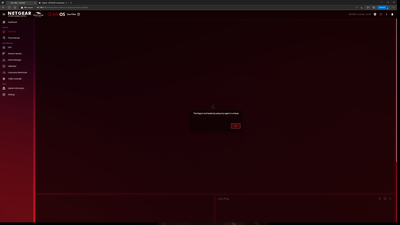

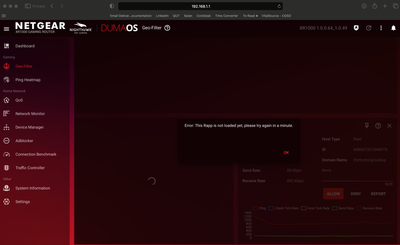

XR1000 geo filter and ping heat map not working
I've never been able to get the geo-filter or ping heat map to work, it just comes up with the below error. I've tried a few things based on previous threads non the same topic:
- increased the retry attempts to 5 and rebooted
- factory reset
- rolled back to previous version of the firmware and then upgraded to current.
- cleared caches and tried incognito window.
- pretty much every browser, 3 different PCs and a bunch of IOS devices and all the same error.
Other than these Rapps it all works perfectly. Any ideas?

  • So don't use Safari as that will force HTTPS which won't work well, it's possible other browsers are trying to do that as well so make sure you're using HTTP to access?
    Are you using Armor by any chance?
    • Birdizdaword's avatar
      Birdizdaword
      Thanks for the reply. I just tried on Microsoft edge and chrome and got the same error. I'm not using Armor.
        Birdizdaword
        Log says this a bunch of times if that helps:
        Oct 8 23:06:18 XR1000 user.warn com.netdumasoftware.procmanager: Rapp com.netdumasoftware.ngdilsync has not responded to watchdog 136
        Oct 8 23:06:58 XR1000 user.warn com.netdumasoftware.procmanager: Rapp com.netdumasoftware.pingheatmap has not responded to watchdog 136
