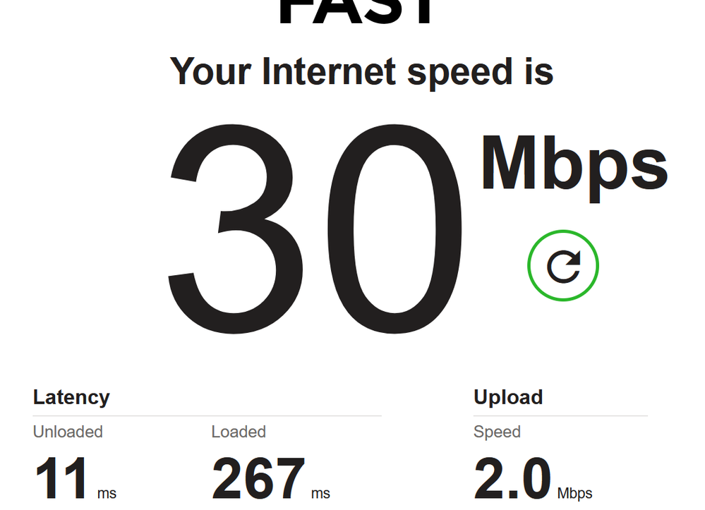

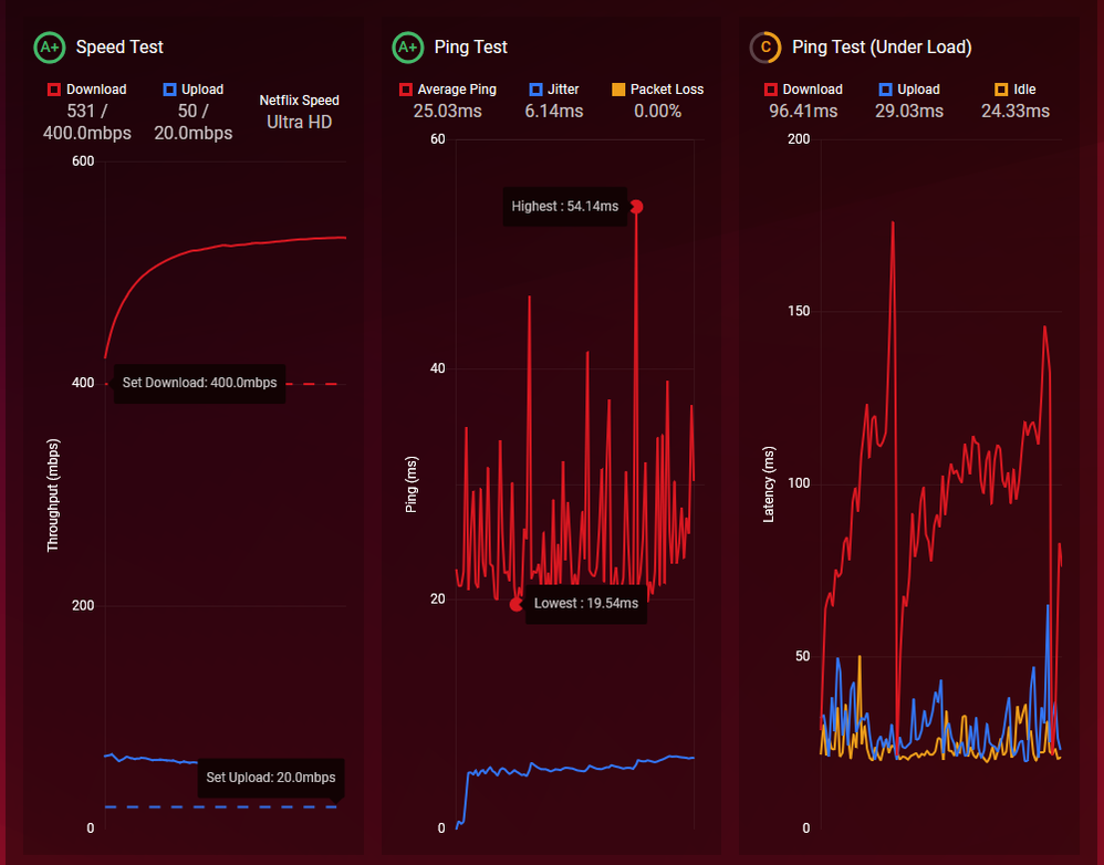

XR1000 v2 Low Speeds all of a sudden
For some reason I am getting low speeds now, we pay for 500/20 and when the router isn't hooked up it works fine since I just tested it separately before and after. I haven't changed any hardware between what I was using previously when my speeds were fine before. I am connected through a wired connection, NOT wireless.
Something with the router is causing the problem. QoS Congestion Control is set to Never.
The statistics page shows 1000M/Full on Wan, Lan3=my PC, and 100M/Full on Lan4=smart bulb hub thing which is fine I don't care about that being 100M or not.
The IPv6 is disabled on the router and has been the whole time, and I already disabled it on the ethernet setting itself previously.
This has presumably happened since last night or maybe a few days prior but I wasn't really checking any speed tests before yesterday to confirm when it actually started except yesterday.
The speedtest on the router itself seems to work fine though????

    • zeth07's avatar
      zeth07
      Firmware: xr1000v2 1.1.0.22_2.1.34
      Modem: Netgear Nighthawk CM2000
      Yes the app speedtest is showing the same speeds as Fast, but as shown the router itself is saying otherwise.
      I've done a power cycle last night and today just trying to test it again and it didn't matter. Besides the fact that it worked fine when it was just the modem anyway when I tested it.
      The ethernet cables I'm using are the ones that came with the product/s. I'm using the black one going from the modem to the router, and the yellow one is going from my router to the PC. The yellow one worked fine when it was just the modem to my pc. I guess I could test the black one again on its own but it doesn't really make sense for that to be a problem when the ROUTER SPEED TEST is showing the correct speeds.
      I feel like I have done a factory reset after the firmware update because I was already having different problems before.
      • FURRYe38's avatar
        I would presume that the speed test point that the router uses may differ from what Fast.com or Ookla uses and maybe under some sort of busy status thus maybe giving some slower result. I would not put too much concern over this. If your getting to speed speeds with Fast and Ooklas then you should be good all around and be fine. I tend to pick results from speed test apps over onboard speed tests and these can differ over time. External test apps tend to be more accurate.
