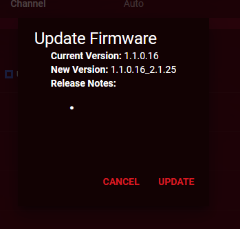

XR1000 V2 NetDuma Firmware Not Updating/Showing Correctly
I recieved this router yesterday and I have already had to hard reset it to get my wired devices to appear under device manager.
Now when I'm logged into the router via web browser on my PC, it constantly says there is a new update.
But at the of the page it shows XR1000V2 1.1.0.16_2.1.25 (See below)
Is my router up to date? and If so why does it keep prompting me to update?
So far the experience has been far from ideal, the UI is very buggy at times and can be extremely slow.
Thanks
Matt

    • Netduma-Fraser's avatar
      Netduma-Fraser
      NetDuma Partner
      You're on the latest firmware so you can ignore that. Are you using Armor or connecting to the interface using HTTPS?
      Have you got Congestion Control set to Always?
