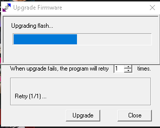

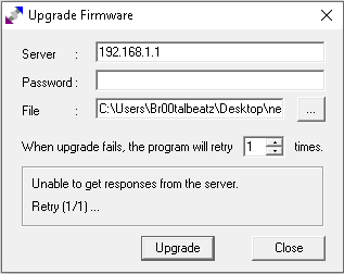

I've tried the Tftp method again however still no joy. It seems to get halfway before saying that its not getting a response from the server. I'm holding down the reset button whilst i power it on and waiting for it to flash 10 times as per the instructions and tried different time intervals but nothing seems to work?
This is where it gets to before it stops.and then this is what i get when it fails
- Netduma-FraserNetDuma PartnerI can't see the images as they haven't been moderated yet, could you upload to imgur and post the link please?
