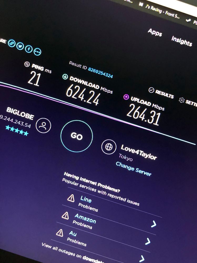

xr500 slow mbps
i cant use my internet speed i test it on speedtest.net but i only have 5-6mbps and originally i have a 1gpbs here in japan when i use my old router my internet speed was like 624mbps

      • kenyz-21's avatar
        kenyz-21
        i tried it but it didnt work i try my speed test in my old router i got this speed in speed test but in my netgear xr500 i only have 20-50 mbps by the way i am using PPPoE
