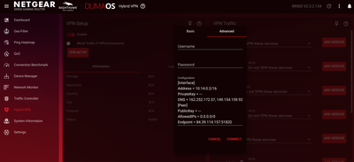

      XR500 V2.3.2.134
      [Interface]
      Address = 10.14.0.2/16
      PrivateKey = ---
      DNS = 162.252.172.57, 149.154.159.92
      [Peer]
      PublicKey = ---
      AllowedIPs = 0.0.0.0/0
      Endpoint = 84.39.114.157:51820
      am I missing something? - can't seem to find the wireguard option sorry!

        Ah okay, it's not implemented currently, you would see it at the top of the config box with a menu for VPN Type to switch between OpenVPN and Wireguard. You'll have to continue using OpenVPN for the moment.
