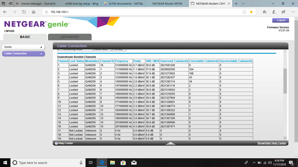

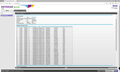

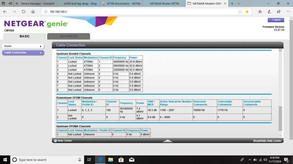

      You could also check your modems dBmV levels they should be within -7 to +7.

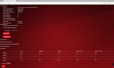

      Btw: you can modify the fan settings. http://routerlogin.net/debug.htm
      T(High-H) - This means that when the temperature reaches this thresh hold the fan will kick in at at faster speed 4000rpm
      T(High-L) - This means that when the temperature reaches this thresh hold the fan will kick in at at faster speed 3500rpm
      T(Low-H) - This means that when the temperature reaches this thresh hold the fan will kick in at at faster speed 3000rpm
      T(Low-L) - This means that when the temperature reaches this lower thresh hold the fan will kick in on the lowest speed 2000rpm
      Note: My fan settings are set to always On full because I like to keep it cool and if the fan dies I can always open it up and replace it.

    Gamer_0224 Are you sure that these drops are not occuring due to issues with the Arris SB8200 Cable Modem? Can you post a screenshot of the status and the event log page of your Arris SB8200 so we can see if there is any issues with upstream or downstream signal or issues in the event logs.

    Fan won't be turn on until hitting the turn-on threshold. You can enforce to turn it on via a hidden page.
