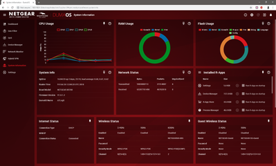

Just got a new XR700 today. I have found that the WAN interface is going down briefly and coming back up every 10-20 minutes or so. This did not happen previously with my XR500 while connected to the same CM600 modem.
I'm able to monitor this by going to Settings > Monitor > Statistics. I can see the WAN port has an uptime of less than 20 minutes while others have been up for a couple of hours. Furthermore, if I start some continuous pings for various domains, I see them drop packets when the uptime for the WAN port resets.
I have tried re-flashing the firmware after downloading it from the web site, I've done a factory reset of settings, and I've tried swapping the network cable for the one I used before with my XR500.
Is there any way this can be fixed with a firmware update? I'm really discouraged by thinking about having to replace it, seeing as it was difficult to find one in stock in the first place. Thanks for reading all of this.

      Hi Fraser,
      I don't think I was able to come up with any rhyme or reason for why the WAN connection would drop. It felt more like it was a matter of time rather than load. I could never seem to stay connected for more than 20 minutes, but the amount of time would vary. I could run speed tests, etc. and it would stay up for the duration of the test and afterwards. I could leave everything alone and still see the connection drop on the statistics page.
      That said, downgrading to the previous firmware has apparently worked around the issue for now. This is looking like a firmware issue as opposed to a hardware one.

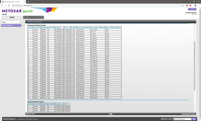

        Maybe Hard Reset the modem and or check the dBmV levels on your modem; they should be within -7 to +7 dBmV. It sounds more like a connection drop or communication issue with the modem. I have yet to see this happon sence beta testing this unit.
