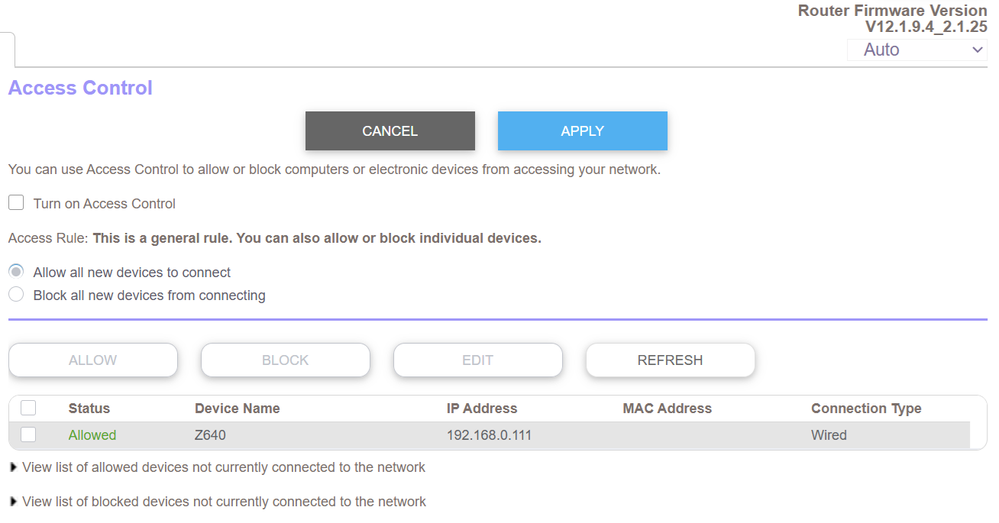

    Not seeing that on my 870 series:
    Did you set up the system initially with Orbi app or have any SPC enable or had a trial running on it at any point in time?
    Been like this for a while now. I think started back on the AX series.

      • FURRYe38's avatar
        Usually either Armor or SPC enabled will change the routers WEB page to direct users to the Orbi app.
        Not sure if disabling those with in the APP will change the routers web page will change it back like mine. I do a factory reset with mine and setup from scratch with a web browser, don't use Orbi app and the Access Controls are seen there on the routers web page.
