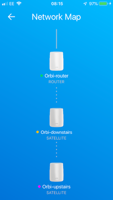

Network map keeps randomly changing on iPhone app
When I look at the Network Map in the iPhone app, I keep getting always different network topology and differen colours for the devices (green, magenta, orange) every time I look at it!
Strangely e...

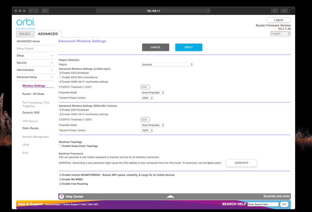

I also have RBR50 with 2 Satellites with couple iPhones. My average speedtest for the iPhone is ~200Mbps-250Mbps. I letf my transmit power at 100% for both 2.4Ghz and 5Ghz. Here is a picture of my wireless settings.
Can you download NetSpot to check if your 2.4Ghz channel is shared with another device or neighbor?
Can you turn off all Satellites and try Speedtest using this link, http://speedtest.googlefiber.net with above settings? (Please reboot Orbi and do at least 3 runs)
There could be some stale settings that are still stuck in Orbi. We could clean those out starting with the Orbi itself if the above speedtest result is still poor. We can do that next. If we're gone through all the experiments and the problem still exist, you could go back to v210 and stay there. You can disable auto-firmware update using this link.
