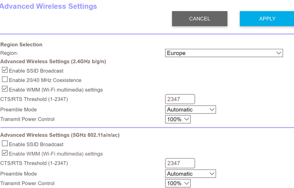

Having disabled the "Enable SSID Broadcast" below for the 5Ghz doesn't turn off the 5Ghz band... even after few reboots and with the other satellites turned off.
i.e. there are still devices connected to the 5Ghz band
How can I turn it off?

Can't see the picture yet, it needs approval.
If devices are connected to 5Ghz when it's not broadcasting, it implies that those devices still remembered/reused their old settings to connect blindly (hidden network) unless Orbi rejects them. To work around this problem, try to change to a new/different SSIDs for 2.4Ghz/5Ghz testing purposes.

So the 5Ghz would be still on and only the SSID is not broadcasted?
If this is the case then I could do the speed test from the device that is on each band. Or am I missing something?
- SW_May 17, 2019Prodigy
Yes, that's correct. It's akin to hidden 5Ghz network. Yes, just verify the test device is connected to the right band for testing and ignore the rest.
