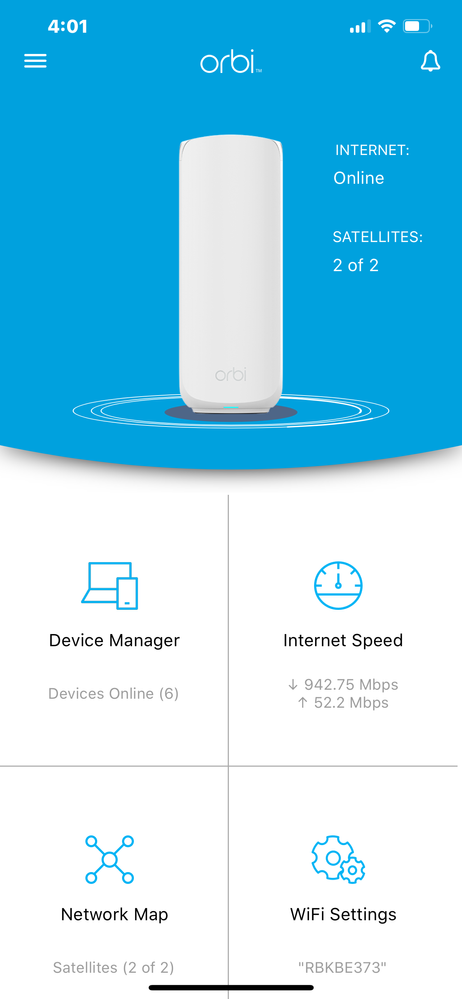

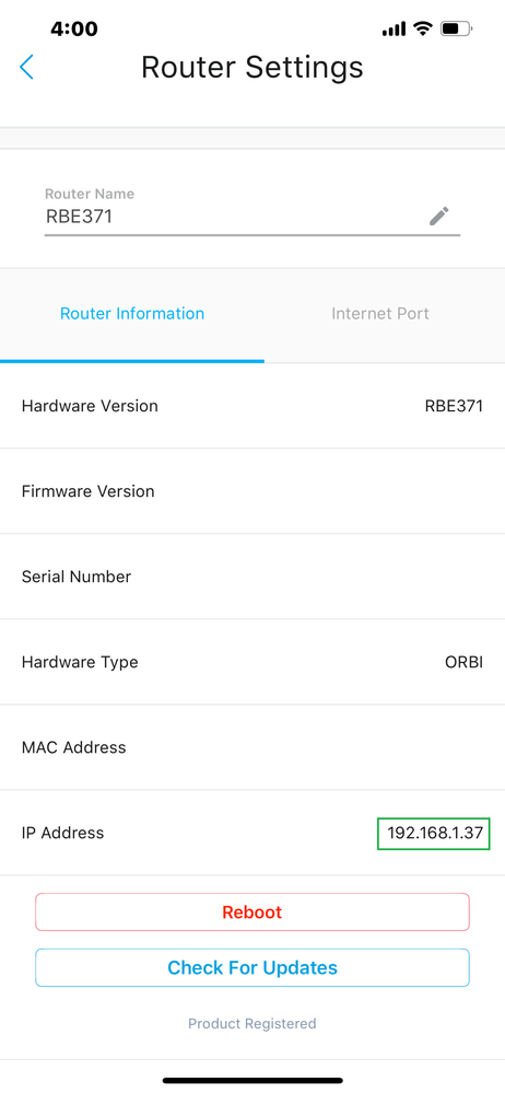

with my ORbi 370 series system, similar to the 770 series, same AP mode process, mines in AP mode and Orbi app is connected to the RBR over anywhere access which had already been enabled.
RBR was first in router mode not connected to any internet services, then configured AP mode as per Static IP address for AP mode configuration using a ethernet connected PC and MS Edge browser, and as the RBR rebooted, I connected the RBRs WAN port to a RAX50v2 I currently have onliine.
Iphone 12 Pro Max with WiFI Private IP address disabled. iOS 18.6.
