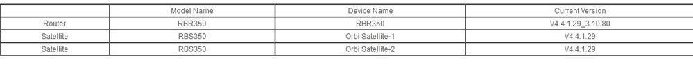

        I cannot see the image you inserted until approved by a moderator.  It is more timely if you attach the image as opposed to insert.  See attached.
        The additional information was helpful, but you still did not answer any of the questions.
        What is the full model number of your router? Look at the label on the device. The AX1800 is a marketing term.
        What firmware version number is on your router? Look on the graphical user interface. "The Latest" is not an answer as it does not provide sufficient information to verify.
        What is the manufacturer and model number of the modem/gateway/ONT that is connected upstream of your router? Look at the label on the device.
