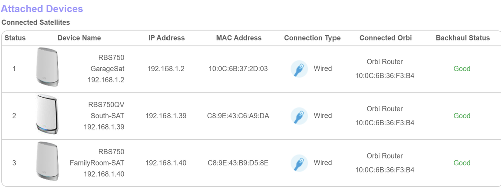

AX4200 with 3 satellites hard wired

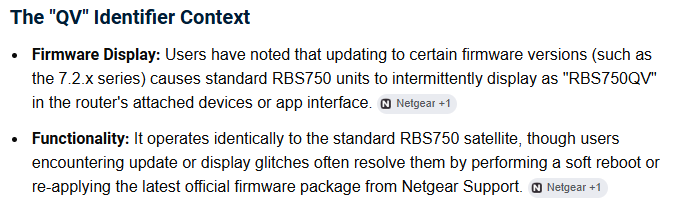

I have 3 RBS750 plugged directly into the back of the RBR750.  My wireless devices all drop wifi at random times. Google AI is telling me that a backhaul status of Good is not correct for a wired connection.

    BH status of GOOD IS correct for both wireless and wired RBS.

  • All on same version of firmware. The 3rd Sat is in the far corner of a 4 car garage.
