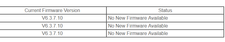

Strangely the modems are set up to auto update firmware and they report the following (image). As for the device names, they are something like NAS Port1 and NAS Port2. How do I manage them one at a time? Through their assigned IPs? I currently log in using the XXX.XXX.1.1 IP.
