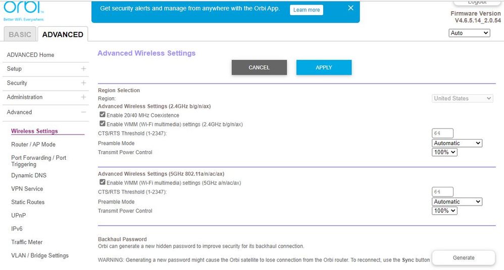

      Which option should I set to 50%? I see "Transmit Power Control" under Region Selection and Advanced Wireless Settings.
      This is the first time I am trying to post a picture on this forum and, for some reason it does not show the picture correctly.
      • FURRYe38's avatar
        Yes, adjust the Transmit Power Control drop down menu.
