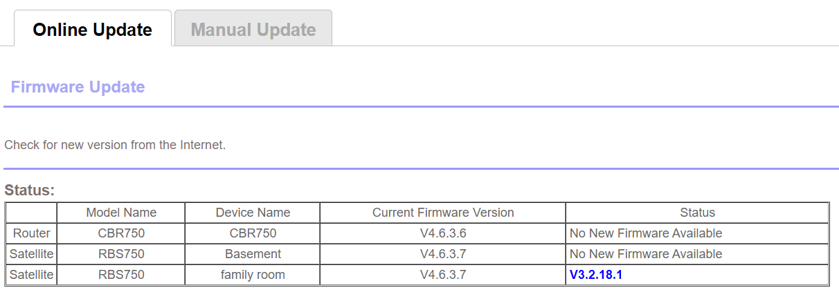

  • Weird update status for my family room? Downgrade? Whats going on? Also, my wifi has been down everyday and TDS says its not them again. I tried reinstalling the latest firmware... lets see if that helps.
    • FURRYe38's avatar
      be sure to power OFF the CBR and RBS for 1 minute or more then back ON.
