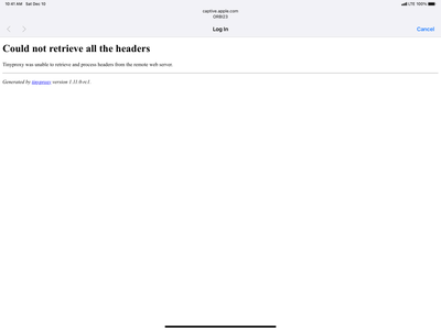

I had this exact issue this week when I did a factory reset on my CBR750 Orbi modem router. When I followed the Orbi app instructions, there’s a point in the process where they tell you to exit the app and connect to the wifi.  When I connected the wifi to the Orbi router, an error page comes up saying “Could not retrieve all the headers.”  The smaller line below it says, “Tinyproxy was unable to retrieve and process headers from the remote web server.”
When trying to connect the wifi, we tried everything with my ISP including reactivating for this particular router and it did not work, even with it already being associated to my ISP account as was described as one of the solutions in the Netgear community.
When you get this error message, hit the “Cancel” button in the top right corner and click “Use Without Internet.”
After this, type in the router address192.168.1.1 and password to access your router directly. It will give you access to login directly into your router and you can set it up from there. Once the router is set up, the internet will come through great as long as the ISP settings were already set to your modem. For me, the error message did not come up again. Quite a few people on the forums have had trouble with this and thought they needed a new modem/router. Some thought they needed the ISP to reset the appropriate modem settings on their end. But all I had to do was follow the steps above and the internet data worked fast and well on the speedtest. It has been more than 24 hours now and everything is working great and back to normal!
