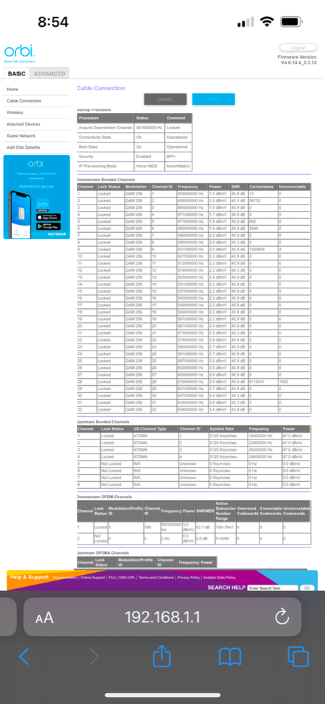

Hello, have very the same issue with CBR750. Since Fall of last year either after NG FW update and/or xFinity work, my CBR750 stopped responding back to Comcast, xFinity app always shows as it is offline, and connection drops every 2 days or so. I had xFinity drop a brand new line from the street poll to the house, no splitters except grounding (required by the code), and still have issues

      i was suggested by xFinity to upgrade from 400 to 800 plan based on number of my connected smart devices (which is BS to me, but i decided to give it a shoot), didnt change anything. I started with CBR750 back in August of 2021 with 3 satellites. Everything worked well, would loose connection once every 2 weeks or so, and Modem was transmitting back to xFinity so i saw it being online. But for the last 6+ months, after several FW upgrades from NG and "service improvements" performed by xFinity in the area, things got progressively bad. Dropping connections, not transmitting back to xFinity so it reported off line all the time. Local head tech tried to help, he run a new cable from street poll to the house, no splitters (except inline connector for grounding and inline power reducer to keep signal strength within NG guidelines). My modem is still dropping connection every 2 days or so. I am beyond frustrated.

        I see some Correct and Un-Correctables that should be zero'd like the other channels.
        Power look ok.
        Have the ISP check the signal and line quality UP to the modem. Be sure the ISP provisions the modem correctly.
        Be sure there are no coax cable line splitters in the between the modem and ISP service box.
        Be sure your using good quality RG6 coax cable up to the modem.
        Start with removing any amplifiers, signal attenuators, or splitters from the coax.
        From there check the line for kinks, damage, moisture in the line.
        Check the connectors for improperly made ends, foil touching the copper coax line, loose connections, bad/old/cheap connectors, or corroded connections. Replace them if you do.
        Be sure to power OFF the modem for 1 minute then back ON.
