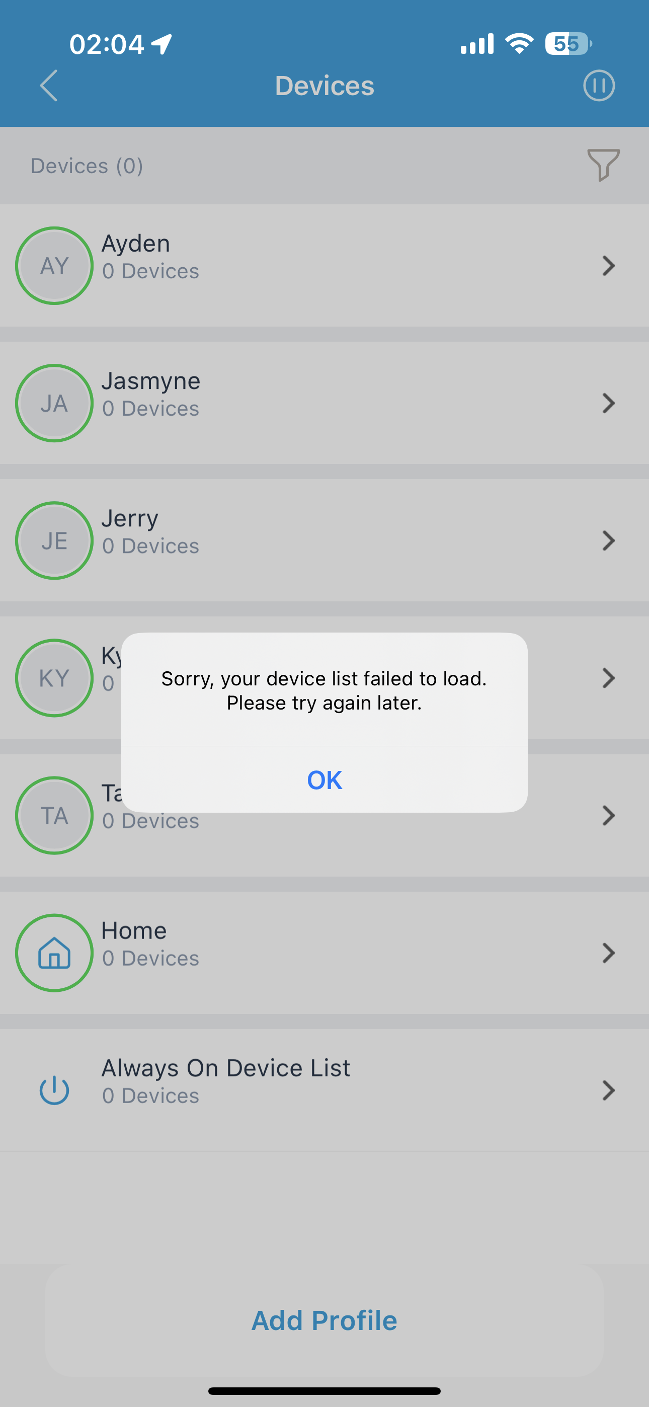

Before throwing my routers to the recycle bin I want to know if someone know how to fix my problem please. My router aren’t showing any devices connected neither my satellite. Any clues / solution? I had already reset everything and still not showing. I got the ax4200 rbr750
    Hard to know with so little information to go on.
    Where are you looking for "connected devices"? The browser graphical user interface (GUI)? A Nighthawk app?
    What firmware version do you have on the device?
    A number is more useful than "the latest". (It may not be by the time people read this.) There can also be newer versions, or "hot fixes", that do not show up if you check for new firmware in the browser interface.

  • FURRYe38's avatar
    Do devices appear on the RBR and RBS WEB page UI?
    Orbi app for Apple or Android?
    Be sure to disable any WIFI Private IP Address features on mobile devices:
    https://community.netgear.com/t5/Orbi-App/NETGEAR-Mobile-Applications-and-Apple-Devices-FAQ/td-p/2220016/jump-to/first-unread-message
    What Firmware version is currently loaded on the RBR and RBS?
    Be sure your using a good quality LAN cable between the modem and router. CAT6 is recommended.
    How many RBS are deployed?
    What is the size of your home? Sq Ft?
    What is the distance between the router and 📡 satellite(s)? 30 feet or more is recommended in between RBR and RBS🛰️ to begin with depending upon building materials when wirelessly connected.
    https://kb.netgear.com/31029/Where-should-I-place-my-Orbi-satellite ‌‌🛰
    What channels are you using? Auto? Try setting manual channel 1, 6 or 11 on 2.4Ghz and 40 to 48 channel on 5Ghz.
    Any Wifi Neighbors near by? If so, how many?
    Has a power off for 1 minute then back ON with the ISP modem and router been performed since last update?
    Be sure to restart your network in this sequence:
    Turn off and unplug modem.
    Turn off router and computers.
    Plug in and turn on modem. Wait 2 minutes for it to connect.
    Turn on the router and wait 2 minutes for it to connect.
    Turn on computers and rest of network.
    Has a factory reset and setup from scratch been performed since last FW update? A complete pull of the power adapters for a period of time after the factory reset then walk thru the setup wizard and setup from scratch with a wired PC and web browser. Recommend setting the default DHCP IP address pool range to the following after applying and a factory reset: 192.168.#.100 to 192.168.#.200.
    https://kb.netgear.com/24089/How-do-I-specify-the-pool-of-IP-addresses-assigned-by-my-Nighthawk-router
    I would power OFF the ISP modem for 1 minute. Factory reset the Orbi router and power it off. Power ON the ISP modem and let it sync. Then power ON the Orbi router and walk thru the setup wizard again using a wired PC and a web browser.
    Press the back reset button for 15 seconds then release.
    https://kb.netgear.com/31486/How-do-I-reset-my-Orbi-system-to-factory-default-settings
    https://kb.netgear.com/000062081/How-do-I-erase-the-configuration-settings-on-my-Orbi-WiFi-System
