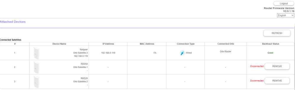

    Ok I was able to take a closer look at this today. I can confirm what CrimpOn suggested.
    I set up my RBR50 in AP mode behind my Orbi AX router. Set a different SSID name on the RBR50. I powered OFF one of my RBS850s that was wire connected to the Orbi AX system. Ethernet connected the RBS850 to the back of the RBR50. Powered ON the RBS850 and waited. No factory reset was performed. I logged in to the RBR50s web page and didn't see anything at first, then the RBR50s attached devices page showed a new RBS online. I didn't have my other RBS ACs turned on or connected. Just the RBS850. I saw config sync and an IP address of the RBS850 appeared.
    I logged in to the RBS850s web page. Log in was not the same as the RBR50, it was the log in PW from my Orbi AX system, however it worked. I was able to get in to the RBS850s web page while it was ethernet connected to the RBR50 in AP mode:
    The config sync took a couple of minuted then changed to GOOD for the status on the RBR50s web page:
    I then removed the ethernet cable from the RBS850 to see if it would auto sync with the RBR850 wirelessly. It would not. Front led on the RBS blinked WHITE then PINK. I tried the sync button the on the RBS850 and RBR50 and the RBS would not sync at all.
    I don't know how stable or how good the operation of the RBS850 ethernet connected to the RBR50 is. I presume it would be ok to run like this if you wanted to try it out.
