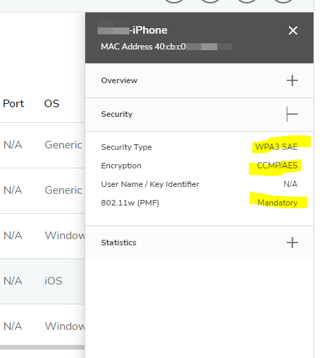

Find out client actual connection type WPA2 or WPA3
Configured wireless setup as WPA2-PSK [AES] + WPA3-Personal [SAE]
How to find out if a client connection uses WPA2 or WPA3 using web interface or Orbi App?  On Attached Devices, I can see the client connects as 2.4G/5G and Router/Satellite but no security type.

    Needless to say,  Netgear Insight does show the related security for the connected client.
