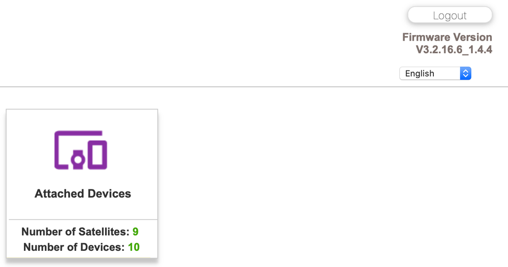

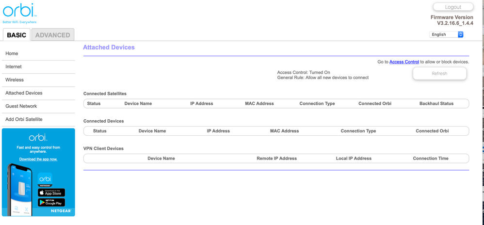

Firmware 3.2.16.6 Web GUI bug
I have updated RBR850 to Firmware  3.2.16.6.
Once you change any device name in the attacjed device list, all devices will disappear from the attaced devices.
I did hard reset the Router, and changed Mobile name in the device list, then all clients in the attached devices disappeared again.
Devices still show in the Orbi App.

  • The issue is still with the latest firmware verion, I did hard reset and soft reset.
    This issue only happens when I connect group of RBS5 Sats to RBR850
    • AwesomeQA's avatar
      AwesomeQA
      Apprentice
      I found the problem.
      Once I unplugged RBS50 sat the admin web will show the attached devices.
      So Netgear should test it and fix it.
