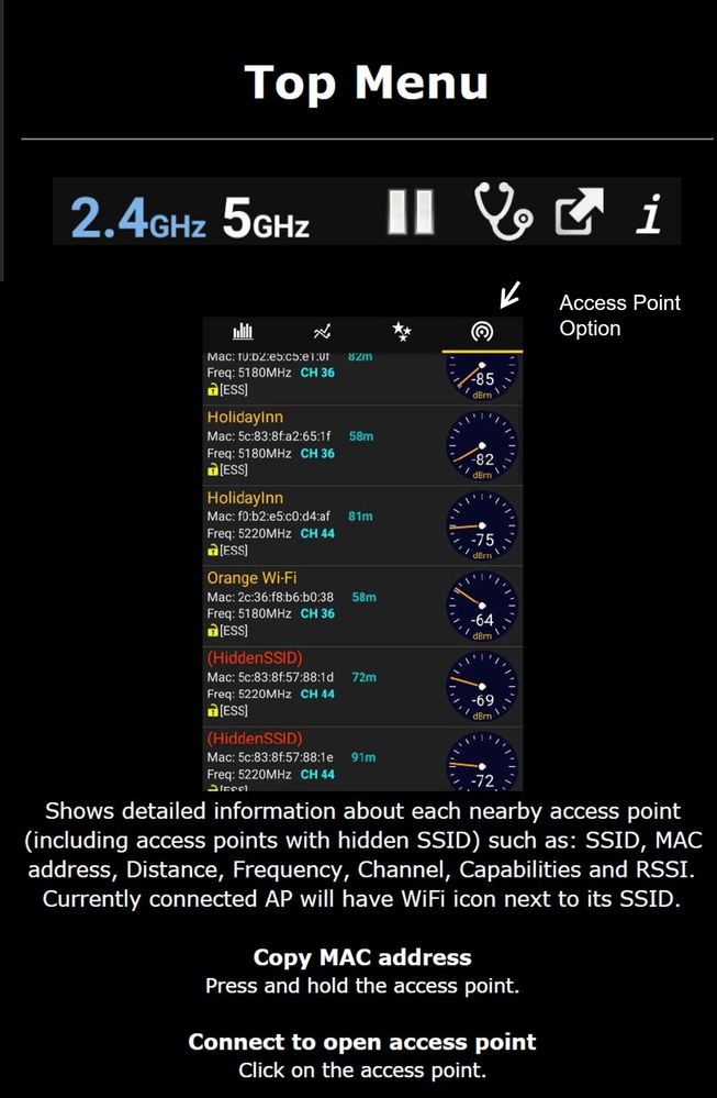

I was playing around with an app on my phone called Wifi Analyzer. I've had the app for awhile, and used it to look at signal strength when I was placing the satellites around the house. On one menu tab called Access Points, you can look at all the SSID, with in range and it will show you the strength of the signal. You can change from 2.4 to 5 channels.
What I learned is if you are displaying the SSID for the 2.4 channel, if you tap that SSID (in your network) you will get an option to Connect to that channel. To test it, I deleted the camera (the one I had a problem with) from my network.

3. Opened the Wifi Analyzer, went to the 2.4Ghz channel under Access Points, select my SSID and connected to it. (enter your network Password to connect). See attached file.
    Congratulations on an excellent suggestion for Android users.  I have a (dim) memory that WiFi Analyzer type apps are not supported on the iOS platform, so iPhone users may not be able to use this method.
    I will do some tests to see how long the phone remains connected to the 2G WiFi channel.  What a cool solution!

      You are absolutely correct, the app I used was on an Android phone so I don't know if this is available for iPhone.
      • CrimpOn's avatar
        CrimpOn
        Well, grrr.  Opened two WiFi Analyzer apps and could not find a way to get it to let me connect.
        Mind sharing which WiFi Analyzer app worked for you?

      Mixed results so far:
      • Yes, it appears that the Premuim version of the app will offer to connect, and the (unpremium?) version does not.
        The premium also does away with the irritating ads at the bottom.
      • On my Sony Xperia Compact with Android 10, the offer to connect does appear except that:
        It will not offer to connect to the top MAC address on the list, which happens to be the one I want.
        It does not give any sort of error message when the WiFi password is entered incorrectly.
        When I do enter the correct password, nothing seems to happen.
      I will install the app on a tablet and see if it works differently.
      (so near..... and yet so far)

        Still batting zero.
        Samsung Galaxy Tab S6-lite, Android 11 also fails (for me).  I remain unhappy that:
        • It does not allow me to 'connect' to the top WiFi MAC address.
        • Entering an incorrect password gives no error message
        • Entering a correct password appears to do nothing.
        Meanwhile:
        • When I start the app with WiFi disabled and do a 'connect', the Android device continues to indicate WiFi disabled.  (WTF?)
        I have attempted to contact the developer for more information.
