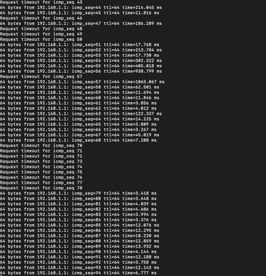

I'm experiencing high ping when connected to router, but normal ping when connected to satellite. I've been searching, but haven't been able to find others with this specific problem.
Can anyone help with possible explanation and solution?
Kind regards!
6 Replies
  • For further clarification, I did a ping test.
    Sequences <70: Connected to router
    Sequences >78: Connected to satellite

      Thanks for the reply. Just to make it clear,  this seems to be a wireless issue. A speaker connected to router by ethernet cable seems to be working fine. Can do more thorough testing later though.
      What Firmware version is currently loaded? V4.6.14.3_2.3.12
      What is the Mfr and model# of the Internet Service Providers modem/ONT the NG router is connected too? It's a Nokia G-041G-P. Can't find any information when trying to search the model number on google.
      Be sure your using a good quality LAN cable between the modem and router. CAT6 is recommended. Thanks. However there seems to be a fine connection between them. No problem when connected to satellite
      Is this ping test done with wireless or ethernet connected PC? Wireless
      Did you turn OFF the RBS before testing with the RBR? Nope I did not.
      How many RBS are deployed? Just one satellite.
      What is the size of your home? Sq Ft? 1345
      What is the distance between the router and 📡 satellite(s)? 30 feet or more is recommended in between RBR and RBS📡 to begin with depending upon building materials when wirelessly connected. There is more than 30 feet. Haven't measured it exactly.
      What channel configurations are currently set on the RBR? 2.4 GHz - Auto, 5 GHz - 48
