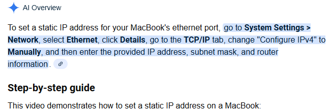

      Thank you for the guide. Do you know if there’s a version for Mac?
  • CrimpOn's avatar
    CrimpOn
    The primary difference is that the User Manual for the 950 and 960 products states that the Satellite Self Service page will appear at IP 192.168.1.250, but this guide states it will appear in an entirely different IP subnet, 192.168.10.250.  This means that a computer must be set to a static IP address in the 192.168.10.x subnet.
    https://www.google.com/search?client=opera&q=set+macbook+ethernet+port+to+static+ip&sourceid=opera&ie=UTF-8&oe=UTF-8#fpstate=ive&vld=cid:0080d072,vid:_nLrN1RBeW0,st:0
