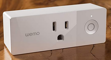

I need to disable 5g to hook up my smart plugs that use 2.4
My smart plugs - WEMO and Meross - have great trouble connecting to the Orbi RBR750.  They need to use 2.4g.  Their support says to turn off or turn down the power of the 5g on the orbi to do it.  I can't figure out how to do this.  Help!  Thanks.

  • Turn OFF any and all RBS first. Turning down the power output of the RBRs 5Ghz wifi radio from 100% to 25% and see if this changes anything. Under Advanced Tab/Advanced Settings/Wireless Settings
    Walk your setup mobile out a way from the RBR to ensure it connects to the 2.4Ghz radio. Disable the wifi radio on the mobile device for 5seconds then back ON.

    Please provide the model number of Wemo and Meross smart plugs.  I just now dug out a Wemo Mini that I bought in Jan, 2019.
    Loaded Wemo app. Plugged in Wemo. Went through configuration.... and it works.
    Did absolutely nothing to my Orbi RBR50 system.  Phone was connected to Orbi WiFi at 5G.  If this is your model, then support is wrong.
    I'm happy to buy a Meross plug to test. Which specific model of Meross plug do you have?

      Amazon delivered the Meross MSS110 today. Installed Meross app, followed directions, plug is working on Orbi WiFi.
      Repeat: Android phone remains connected to Orbi 5G WiFi channel.  Did nothing to the Orbi system.
      Now have 13 brands of smart plug that connect to Orbi WiFi "no problem."

        Sorry for my delayed response.  I finally figured out how to turn down the radio signal for the 5g, which involved Advanced-->Advanced-->Wireless settings.  (I was just doing Advanced-->Wireless before, which was incorrect).
        When I turned 5g down to 25% temporarily, I was able to link the Meross.  When I turned it back to 100% and tried to link a second Meross it did not work.  Not sure why my system functions differently than yours.  I see from the discussion boards than a number of people seem to have the same problem as I in their setup functionality.  Note that I have had the same issue with WEMO.
