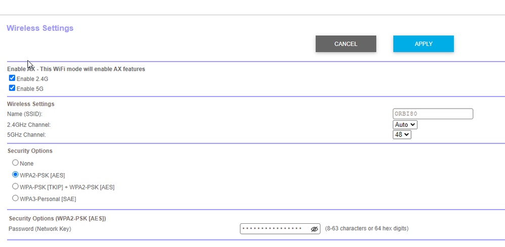

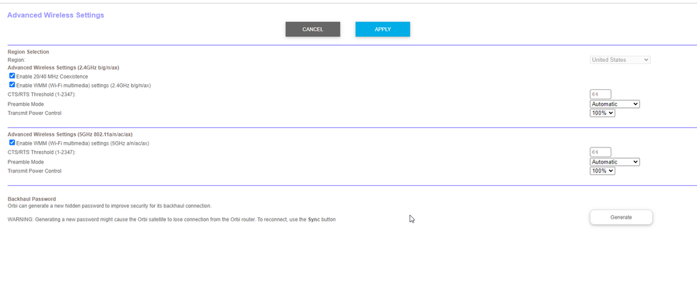

Good afternoon.  I have a Orbi RBR750 and two satelittles.  AX4200 is the system.   I am having issues with satelittes disconnecting and reconnecting.  Also noticing when I do a reboot of the router that all devices only go to the router not the satelittes.  Even after awhile the devices will not connect to the closest satelitte even if its right next to it.  Both satelittles say they have a good backhaul connection.  I am not sure what is going on with it.
On another note does this set have daisy chain?  When I go to the router settings then advanced and then I don't even have an option to do it.  See my settings view below.  I have firmware V4.6.5.14_2.0.54, so I believe that is up to date.

    What channels are you using? Auto? Try Auto and 48 on 5Ghz. Or try setting manual channel 1, 6 or 11 on 2.4Ghz and 40 to 48 channel on 5Ghz.
    Any Wifi Neighbors near by? If so, how many?
    Try disabling the following and see:
    Armor, and Traffic Meter and Set 20/40Mhz Coexistence to 40Mhz only. Set CTS to 2347. Set Short preamble instead of Long preamble modes. Save settings and reboot the router and satellite(s). Under Advanced Tab/Advanced Settings/Wireless Settings.
    Try disabling AX mode on the RBR under Basic Tab/Wireless seeings, uncheck the box next to 2.4Ghz.

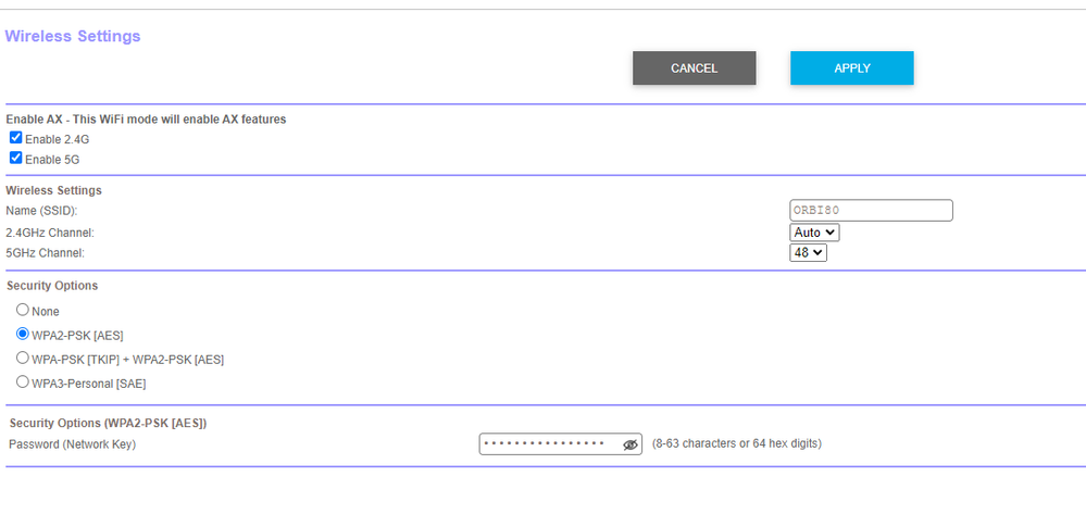

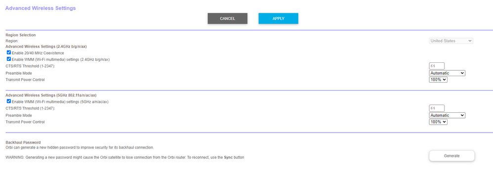

    • cac3893's avatar
      cac3893
      THis is what settings I had.  See attached photos.  I have charter internet.  ARRIS TM1602A modem.  My home is 2 stories.  about 3800 sq ft.  My router is connected to the modem on far end of basement.  Then satellite on other end of first floor and the other on 2nd floor mid floor plan.  I would say my other neighbors have wifi but not sure on type.
