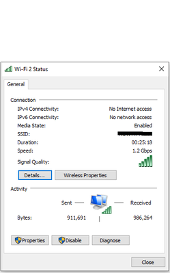

I bought an Orbi RBR850 as it could transmit WiFi 6e using 6000AX protocol. So as I understand it, that means I could be able to recieve (in the regions of) 6000Mbps, or 6Gbps.
As of yet, I am only receiving 1.2Gbps which is much slower than I was expecting, even after allowing for 'real world speeds'. I live in a small 2 bed house, and I am sat next to the router when I get this speed.
I am checking this speed in the WiFi adapter properties on the Server and the Orbi app which roughly agrees.
Am I missing something here or is the 6Gbps transmission rate a marketing pun that I have fallen for?

    Yes you did fall for some marketing.
    its an AX6000 device.
    Its triband with the backhaul being 2400mbps, and the fronthaul being 2400mbps on 5ghz and 1200mbps on 2.4ghz. (can't connect to both at once). And thats with a 4x4 antenna.
    Most phones/wifi cards are only 1x1 or 2x2 devices. (antenna). So your 1200mbps connection is right in line with what you can expect from a 2x2 device.

      So from what I've read on the datasheet, it has 2 channels at 2.4Gbps (one for WiFi and the other for satellites), and one channel at 1.2Gbps but I'm obviously only getting 1.2Gbps,which is half the maximum speed on the 5Ghz band. Have I understood that right and am I doing something wrong?

        Still reading a little wrong.
        it has 3x channels being a triband.
        1 that is 2.4ghz and is capable of 1200mbps over 2.4ghz AX connection with 4x4 antennas
        1 that is 5ghz that is 2400mbps using a 4x4 setup that is dedicated to fronthaul (connects to devices)
        1 that is 5ghz that is 2400mbps using a 4x4 setup but is backhaul (router---satellite only)
        The 5ghz 2400mbps using 4x4 antenna? Is means if you have a 1x1 antenna it connects at 600mbps max, 2x=1200mbps, 3x=1800mbps, 4x=2400mbps.
        and like I said, it can't connect to the 2.4ghz and the 5ghz at the same time. Its one or the other.
        The 2.4ghz can be used for failover on the dedicated backhaul but it rarely does that if setup properly.
        Most cell phones/laptops only have a 1x1 or 2x2 antenna setup.
        so if you're connecting at 1200mbps with a device that is 2x2 antenna setup, thats the maximum link speed it can get.

    "I bought an Orbi RBR850 as it could transmit WiFi 6e using 6000AX protocol." <FYI, the 8 series does NOT have 6Ghz or 6E support. Only Orbi 9 series has that.
