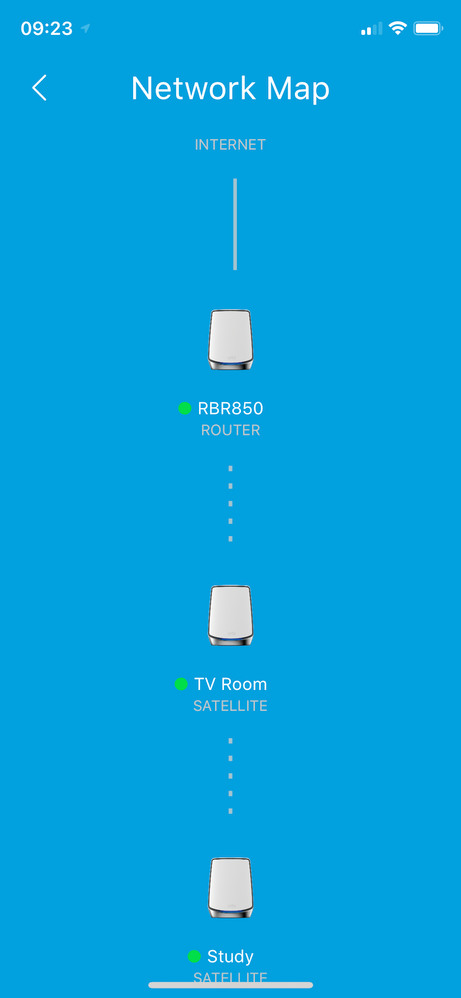

Hi, I'm new to this community but hoping someone can shed some light on this strange issue.
RBR850 - FW V4.6.3.16 and both RBS850 have FW V4.6.3.16
Orbi App is V2.11.6.0 on iPhone

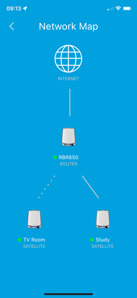

Since installation about 6 months ago, everthing has been great, the perfomance of this set up has provided me with excellent service and connectiny for all my devices.
However, just a couple of days ago, I noticed that one of the RBS850 units was glowing blue. I checked on the App and saw that the network map layout has changed from being the RBR connecting directly to both RBS units in a 'star' format, to now showing the RBR connecting in a 'serial' format to the first RBS and then from that RBS to the next RBS? I also noticed that the connection lines shown on the network map keep changing from solid lines to dotted lines?
Thanks in advance for any insights on this.

    Is the "Study" Satellite connected to the router via wired or wireless?
    Please turn off both router and satellite and check if it will change the status.
    For comparison, kindly access router Web UI > Attached devices and check Satellite connection status.
