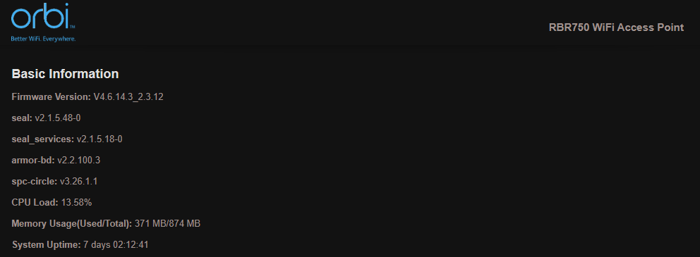

mingcyu wrote:
Can I assume that the need to restrict the DHCP addresses is for those running in Router mode and not AP mode? I currently run mine in AP mode, so the DHCP setting is set as no
7 good days of up time. FW was updated to v.13 and RBR and RBS were factory reset and setup from scratch.
RBR in router mode. CAX80 in modem mode.
RBS ethernet connected for backhaul.
Putting something else online to test.
