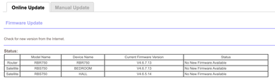

  • Hi All,
    I did the updates as per first post and all appears ok, the 2 satellites updated together, however when I checked all after also doing the RBR, the firmware versions on the 2 satellites are different, which seems impossible as they both updated from the same file.  Anyone else seen this?
    Thanks
    • SGDH's avatar
      SGDH
      I don't think my screen shot worked. My point is i updated both satellites together using manual process and one updated 4.6.7.13 and the other 4.6.7.14. Surely a strange situation? I tried again and it made no difference
      • FURRYe38's avatar
        To correctly manually update the one RBS, you would need to download the RBS fw file, unpack the FW.zip file. Log into the IP address given to the RBS and use the RBS web page directly to send the FW file to the RBS.
