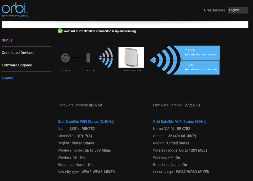

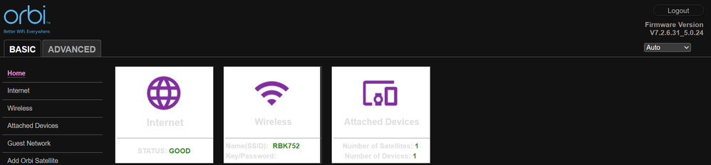

Updated my RBK752 system today to v.31. System was already at v.21.
I checked for FW updates thru the RBR web page to see if I could use the Update All button however v.31 was not available here so I manually applied the v.31 FW, RBS first, then RBR lastly using MS Edge browser.
After the sytem was back to ready, I powered off the RBR and RBS for 1 minute then back ON.
Both web pages were accessible on the RBR and RBS:
