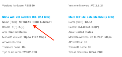

Update went smooth but after 2 days had to shut down satellite because it won't let clients get an IP from DHCP server. RBR and RBS are in AP mode (wired) and were running fine since February 2021. Router is a draytek vigor 3910.
What is the best way to factory reset a RBS?Found the thread with the procedure regardsPS. RBS started also broadcasting ORBI51_HIDDEN network

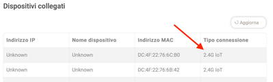

Unlike the primary and guest WiFi networks, the IoT network has an option to turn the 2.4G and 5G WiFi channels on or off. If only the 2.4G WiFi channel is enabled, then the smartphone running the IoT app can be guaranteed to connect at 2.4G when performing the device setup.
- DarkNetApprentice
I think adding the IoT network is a good idea and I especially like the ability to turn off 5GHz when needed. My update to 7.2.6.21 went well and I did the trick of turning off the RBR and RBS's (2 of them) for a few minutes after the update. What bothers me is that when logged in to the RBR I don't see mention of the IoT SSID on the dashboard. I have it enabled. I can see on my mobile devices that it is being broadcast and I can connect to it, but it isn't included on the dashboard along with the main SSID and the Guest SSID. I also wish there were a few notes about the new SSID functionality. From experimenting I see the IoT SSID gives out IP's on the same VLAN as the main SSID and they don't seem to be isolated. I currently have my IoT devices on the Guest SSID and they are isolated from each other and the rest of my network (internet only). I'm not sure the advantage of moving them to this new IoT. Am I missing something?
