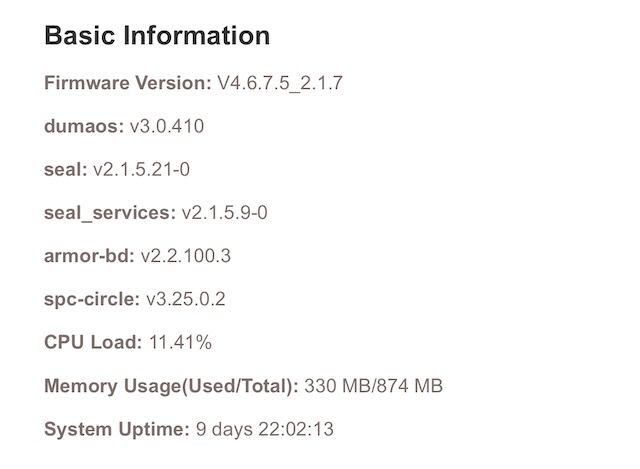

A long time lurker here, but here's my contribution. Been running 4.6.7.5 on my RBK853 system for 3 weeks. Initially, after updating the router and all satellites to 4.6.7.5, I caught my router rebooting almost daily. After disabling all logging, system uptime is now almost 10 days without any problems. Also, memory consumption has stayed quite low.
I have router mode enabled, ax wifi (WPA3), guest network (WPA2) with full power. Armor, Circle and add-ons disabled. All logging disabled.
If you re-enable logging, does the memory usage go up?
I was on this version of FW. Thank you. I heard there was a beta version released after this one?
Just curious if anyone has seen any Memory Usage spikes upwards or towards maximum usage value and if so, see any problems?

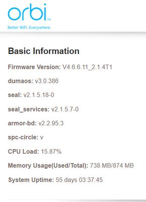

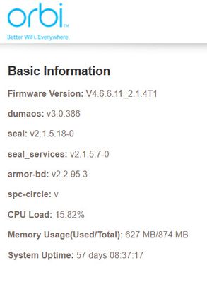

- tjtrimbleLuminary
Mine crept up to 738MB over a few weeks then went back down to 627MB 2 days later. I saw this same behavior a couple of weeks ago. I have all the logging turned off...not sure what is being written/stored in memory. So far it hasn't maxed out and I'm coming up on 60 days up time.
