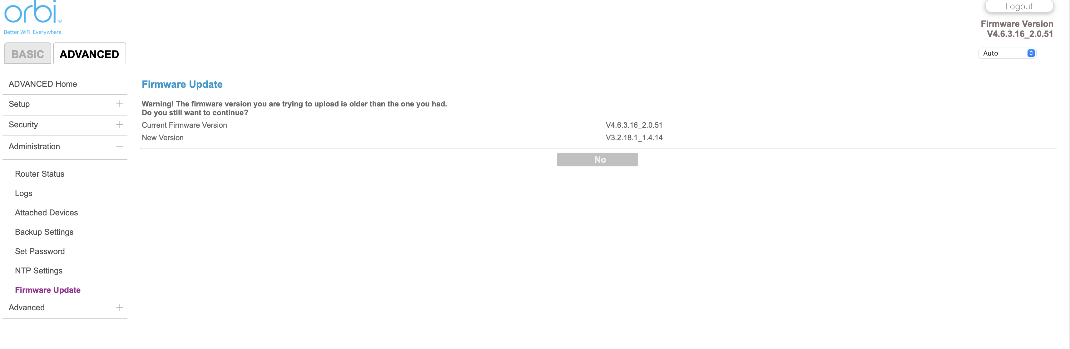

- GarwoofooApprentice
Is there a guide as to how to downgrade back to v3, and to prevent Netgear automatically reinstalling the broken v4 firmware?
- GoldenRetroGameApprentice
This update has been absolutely terrible for me. Devices will not gracefully roam between the router and satelite. Instead, they just drop connection and usually won't automatically reconnect. iPhones rarely stay connected, even when not moving around.
I didn't even want this update. 3.2.18.233 was working perfectly for me, but the system decided to update itself. It should be the user's choice if they want to update, specifically to avoid issues like this.
You can go back to v3:
A complex series of workarounds to force a firmware downgrade and block automatic updates (both things that Netgear don't officially support) isn't the solution most users are looking for.
In my case, as I am using the Orbi in AP mode and my router doesn't allow individual sites to be blocked at router level, it's not even a workable solution, as the system will simply "upgrade" itself again.
Netgear needs to fix this, urgently.

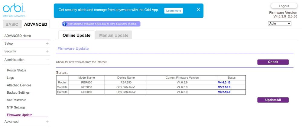

- QuaksyxTutor
I'm currently on 4.6.3.9. I noticed the following within the Online Update page tonight -- how is this possible (i.e., router being offered update to 4.6.3.16 but satellites offered 3.2.16.6)?? Boy, if I were to hit the "Update All" button, I'm sure I'd have quite a problem....
Quaksyx wrote:I'm currently on 4.6.3.9. I noticed the following within the Online Update page tonight -- how is this possible (i.e., router being offered update to 4.6.3.16 but satellites offered 3.2.16.6)?? Boy, if I were to hit the "Update All" button, I'm sure I'd have quite a problem....
I think the simple answer is that they butchered this release. There was obviously a reason they felt the need to rush this out, but in doing so they've created quite a mess.
