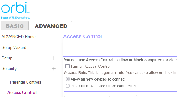

  • CrimpOn's avatar
    CrimpOn
    FormerPro wrote:
    After a short power outage, I cannot logon to the router with my two Apple devices
    but am unsure why the two Apple devices cannot connect. Any suggestions?
    Logon and connect typically have different meanings:
    • Logon usually refers to being able to open the Orbi web interface (http://orbilogin.net ) after being connected to the network.
    • Connect usually refers to being able to join the network.
    Apple's randomizer feature creates random values for the hardware MAC address (rather than presenting the actual hardware address). https://support.apple.com/guide/security/wi-fi-privacy-secb9cb3140c/web
    This causes the router to believe they are "different" devices that it may not have ever seen before.
    It might be useful to examine the Orbi web interface Advanced Tab, Security Menu, Access Control and see:
    • If Access Control is enabled or disabled.
    • Which setting has been selected for New Devices.
    • FormerPro's avatar
      FormerPro
      Thank you for your suggestions. I checked the advanced settings and it was already configured to allow new devices to connect. So I decided to "forget this network" using my iPhone and then "joining this network" and reentering the password and then I was able to connect. I then tried to "join" with the iPad and it connected with no problem.
