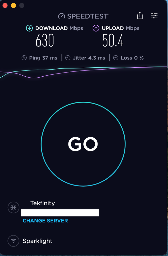

    Heres what I get with my Mac Book Pro OSX 12.2 beta, connected at the RBR at 1300Mpbs:
