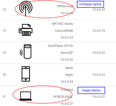

I recently setup a NETGEAR Orbi RBR860 with two RBS860 Satellites. All devices except for one works great on the system and flawlessly transitions between router and satellites. Satellites are within 30 feet of router.
When my Lenovo Thinkpad laptop connects to the router there are no issues. When it connects to the Satellites, I get a "No Internet, secured" error. I have the most recent firmware on all devices, I've cycled everything off and on, I reinstalled my WiFi network driver, I've removed all ethernet connections to other devices, I've switched to 2.4 only and 5.0 only networks, I've selected specific channels and nothing has allowed my computer to have internet on the satellites.
Interestingly, the problem laptop shows up as a "network" device while my working laptop shows up as a "laptop"
I'm at a loss on what to do next, any advice? THANK YOU!
  • SOLVED! It was an Orbi settings setup error... When trying to get Orbi to talk to Starlink, (spoiler - you need an Uncontrolled Switch) I selected "Use Computer MAC Address" for "Router MAC Address". The computer was fine when connected to the router, but failed when connected to the satellites. I realized I forgot to set it back to "Use Default Address" and once I did, problem solved. Thank you for your help, CrimpOn.

      This explanation is extremely helpful, thank you! The MAC address through "ipconfig /all" matches the one shown on the Orbi device list. Also, my WiFi settings does have the ability to randomize addresses, but the feature is not turned on (generally or for my specific network).
      Good call on just exploring more into the "No internet, secured" error. My WiFi adapter is an Intel(R) Wi-Fi 6 AX201 160MHz (OUI returns "B0:60:88 Intel Corporate") and I think I'll look into specific issues with this adapter next. Thank you for your help!
