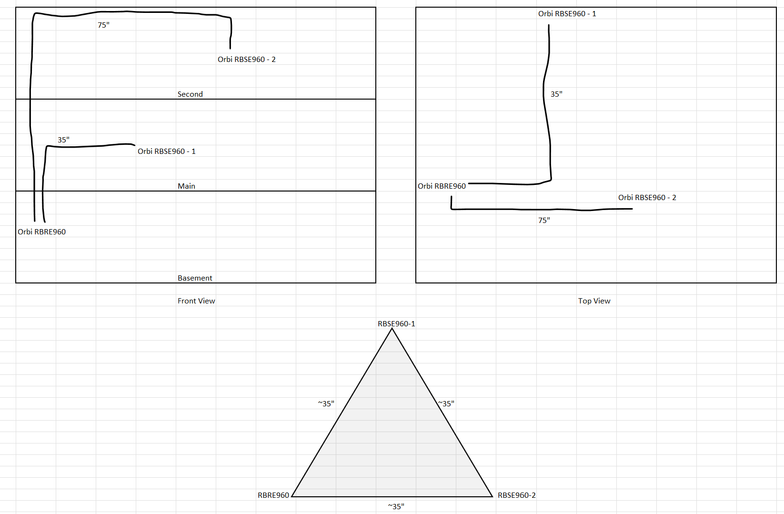

    • FURRYe38's avatar
      Can you draw up a home floor lay out and mark where you normally have the RBR and RBS placed and distances between the RBR and RBS and each other and post it here?
      • bullm00n's avatar
        bullm00n
        Virtuoso
        So, the idea is coverage for each floor, coverage for cameras outside front, coverage for deck outside back.  The RBRE960 is located near the demarcation point at the wiring panel with the xFi Modem and Netgear switch that is wired to most rooms.  Sats are wired directly to the Router bypassing the switch.  I could, with some minor gymnastics, put the router into the center of the house on the main floor temporarily to get better coverage with the Sats disabled if it comes to that.
