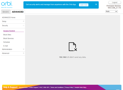

Orbi 6E Router RBRE960 only shows error on Access Control page
Just replaced my RBR50/RBS50 setup with a RBRE960/RBSE960 setup. Things worked pretty well. I did everything step by step over something like 6 hours, bringing my switches and devices online in sections. Among other things, I create reserved IP addresses for ~25 of my network infrastructure devices (switches, PDUs, KVMs etc. that I need to have access via their fixed IP) and make sure each of the ~40+ devices have proper name/brand info put in on the Attached Devices page instead of whatever the router decided they should be, usually wrong and not following any naming convention.
Anyways, as I was doing that, the Access Control page (under the Advanced/Security menu on the admin webpage) was available, showing me the devices as I added them, split between what is currently connected vs. not. Cool.
Then, after about 30 devices, as most of my network came online, that page started showing a blank grey page with a large "earmarked document page with an X in one corner" icon in the middle of the page. What? When I move my mouse over that grey area, it gets lighter and the sentence "192.168.1.1 didn’t send any data." appears under that icon. Rebooting the router didn't work. Trying from different PCs didn't work.
What is going on?
I wanted to telnet into the router to see if any of the environment variables holding modified device info is corrupted due to whatever, but seems telnet is blocked on this router. I posted my question about that separately.

      I never report problems without making sure I am on the latest of everything, so everything is the latest:
      • According to the admin page, "Firmware Version V6.0.3.85_3.1.15", out of the box. Trying to update the firmware doesn't bring anything new. And, https://www.netgear.com/support/product/RBRE960.aspx#download shows that 6.0.3.85 is the latest.
      • According to Xfinity, I have "Voice and Data Modem Technicolor CGM4140COM". Their standard non-6E black box. It is in Bridge mode. So much so that they cannot see into my network that is hiding behind my Orbi router. Both the ORBI router and the Xfinity modem have been rebooted during my troubleshooting of this, to no help.
      • I have tried from the latest Microsoft Edge as well as latest Google Chrome on two Windows 10 PCs with the latest OS (as updated yesterday morning, before I switched from RBR50 to RBRE960). I get exactly what I described.
      • I just now also tried via the latest Apple Safari on my iPad with the latest iPadOS: it doesn't show the grey area with that icon, but instead the same area has the text "Unable to connect Tinyproxy was unable to connect to the remote web server. Generated by tinyproxy version 1.11.0-rcl."
      • Here is the screenshot. I didn't know that I could copy/paste screenshots into these posts. Otherwise I wouldn't have tried to explain an icon. 😆
