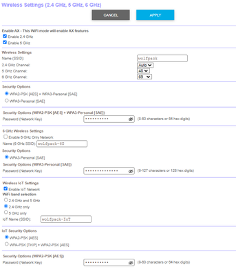

      Wireless config is attached. Closest neighbor us about 500' away.
        Try channels 1 and 40.
