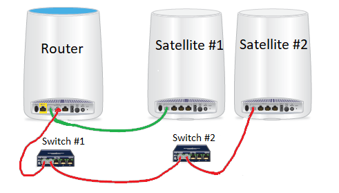

Hello,
My Orbi Satellite-2 will not connect via hardwired Ethernet, it will only connect to the backhaul via 5G. The firmware on the satellite is Hardware Version: RBS840
Firmware Version: V3.2.18.1_1.4.14
This is my topology, please excuse I made with MSPaint

Use same configuration for my RBS. 1 RBS has 3 switches daisy chained on one segment after the RBR.

Do the RBS connect to the back of the RBR and see a wired status? I dont understand. Could you maybe rephrase? As soon as I plug the Orbi Satellite-2 into the TPlink switch, it gets a 1Gigabit link light and starts flashing like its communicating, but it immediately disappears from the Attached Devices list in the Orbi RBR page.
What is the Mfr and model# of the ethernet switch in the configuration?
switch #2 = TP-Link TL-SG105-M2 and switch #1 = TRENDnet TEG-S380
there are multiple other devices plugged into those switches and working just fine, the only issue is the Satellite-2
What CAT# lan cables are you using? CAT6 is recommended. I'm using CAT6 for everything.

I've replaced the TP-Link switch with another TRENDnet TEG-S380 and the Satelite-2 is still not showing up. It seems pretty ridiculous to me that Netgear cannot create a backhaul connection through 2 simple switches.
- heywoodjahblomeAspirant
Same result with TP-Link TL-SG105. No wired backhaul connection for the Satelite 2
What happens if you swap RBS with each other, does the problem follow or remain?
I swapped the satellites as you suggested. Satellite 1 is where 2 was and satellite 2 is where 1 was. Now, since satellite 1 is where 2 was, satellite 1 is now having the same issue as what satellite 2 was having before. Satellite 2 is now working hard wired, but it has a direct connection to the back of the RBR 840 and it's not passing through a switch. If I had known that these satellites could not be hardwired through a switch, I would not have purchased them. For $800 dollars it is really crazy to me that these things cannot communicate with each other through a simple switch. I have tried 3 different switches and none of them work. I am really disappointed with this.
